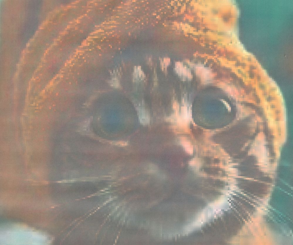

Also...  For a few weeks now (or longer) the images are coming out darker than the originals.  Lightening the originals up doesn't seem to help and usually changes the tone/feeling I'm trying to get.

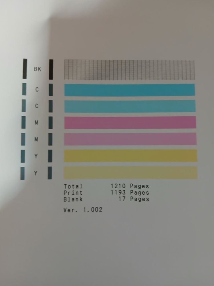

First, let's print a test page from your printer.  Please load plain paper into the cassette and then follow these steps:
Press OK one time on your PIXMA TS6420a.
Use the down arrow to select Maintenance and press OK.
Press OK on Nozzle Check.
Select Yes and press OK.
A test page will print.
Please take a photo of the test page that just printed and then attach it to your reply of this post.
Hopefully these will come across.  The printed page also curled up almost immediately.
Thanks!6420a test page 3-15-26.jpgdirectly from computerdirectly from computerprinted page from computerprinted page from computer
Hi Vestal,
Thank you for the images.

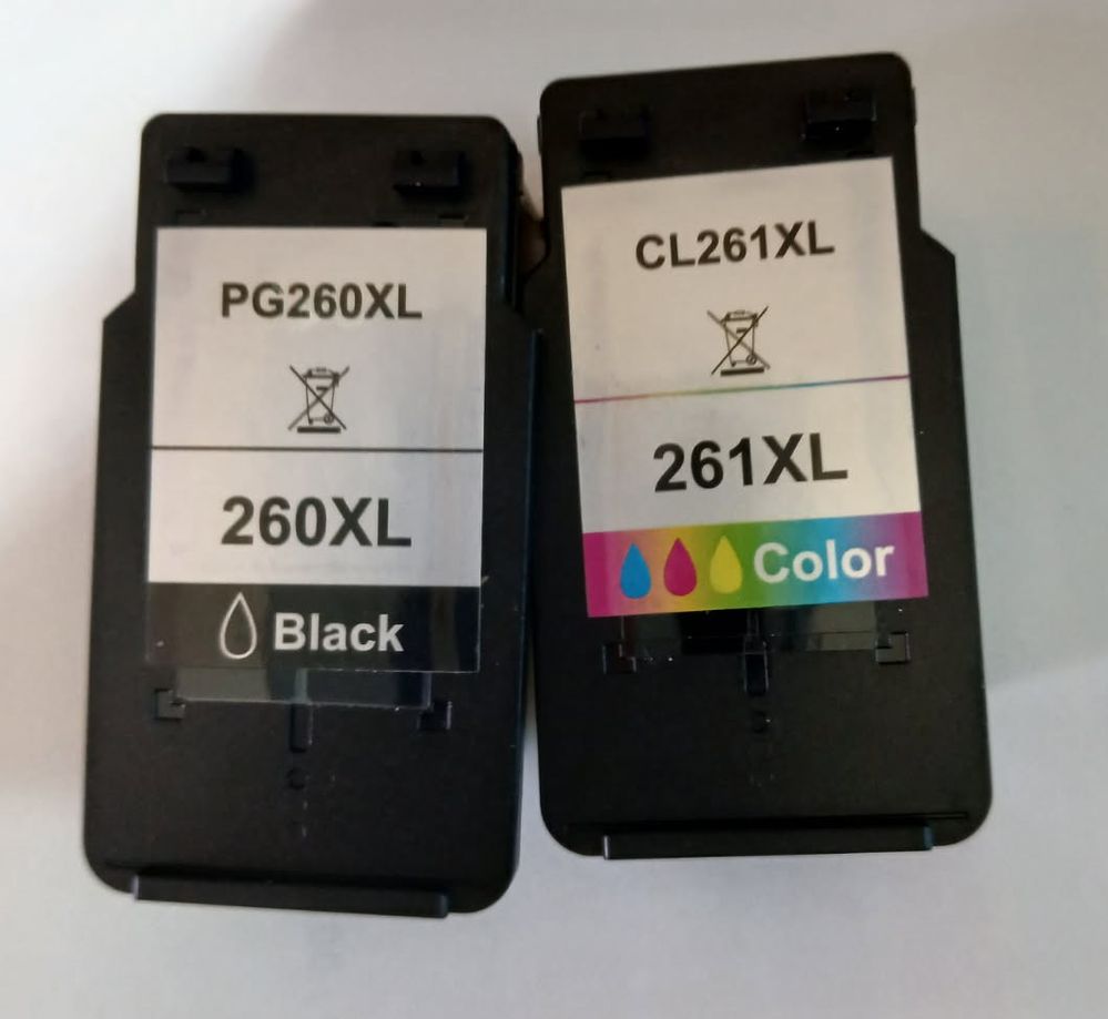

Next, please remove both ink cartridges from your printer and place them on a sheet of paper with the labels facing up.  Please take a photo of both ink cartridges and please reply to this post with that image.
Vestal
Up until about a week ago, printer was working fine.  About 25% color ink remaining, 75% black
Are these remanufactured or refilled cartridges, or are they genuine Canon Cartridges?
Hi Vestal,
Thank you for your reply.
The colors that you are experiencing in your printouts are caused by using third party ink cartridges.  The colors in the nozzle check you posted are not printing correctly.
It is recommended that only genuine Canon ink cartridges are used with your PIXMA TS6420a.
