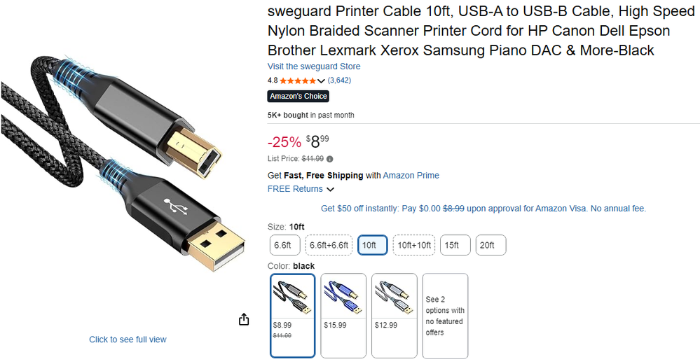

My first Canon printer was the Pixma TS3720 which is basically the same printer as the TS3722 but has no lcd screen. I did not keep it because it would not print 8x10 borderless prints on glossy paper, or any paper for that matter. Other than that I had no problem with the printer. I gave it to a good friend who needed to print from mobile devices and I purchased a Canon Pixma MG3620 which I find to be a very good printer.  But I digress. The setup for the TS3720 was simple, I unpacked the printer, made very sure to remove all shipping tape, including the protection on the ink cartridges, powered up the printer, installed the cartridges, downloaded the drivers and software to my pc,  and installed them making sure to connect the printer to my Windows 11 pc when the software instructed me to do so not before using a USB/printer cable. The same for when I  installed the MG36520 printer. Wireless and USB connection for the TS3722  cannot be active at the same time. I got around that by enabling printer sharing on my PC which allows my Windows tablets, one is 10 and one is 11 to be able to print wirelessly.  There are apps that can be added to the my pc and any smartphone which will allow the phones to print as well. This is the correct cable and it works with Windows 10 as well as with Windows 11
[Commercial link removed per forum guidelines and replaced with screenshot to facilitate discussion.]
