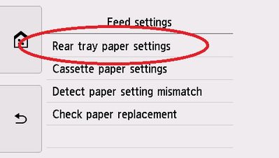

There is a setting on your printer that will specify the size and type of paper loaded in the rear tray and in the cassette.
If you set the rear tray to a paper size that you are not using, then the printer will feed paper from the other paper source.
For example, if you set the rear tray to 4" x 6" and the cassette to Letter, when you print with letter size from your Mac, the paper will be fed from the cassette.
To set the rear tray to 4" x 6", please follow these steps:
1. Tap the gear icon.
2. Tap Feed settings.
3. Tap Rear tray paper settings.
4. Tap Change.
5. Select a paper size that is NOT the size you wish to print with.
6. Select a paper type.
7. Tap Yes.
Once set, please attempt to print.

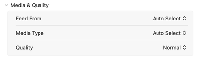

You can also specify the paper source in the application that you are printing from.
Let's take TextEdit as an example. Click on File and Print and scroll down to the Media & Quality section and change the "Feed From" from "Auto Select" to the location of your paper in your printer.
