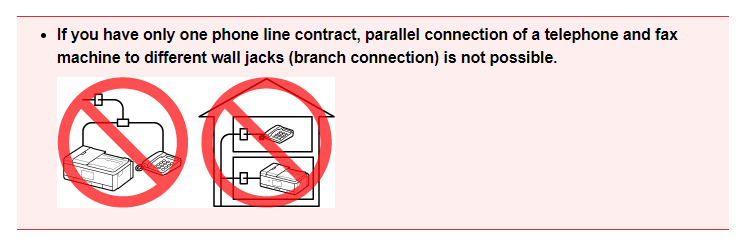

Also I wanted to use the fax option and tried to set it up according to the so-called directions, I have only 1 phone line with voice mail but when people call they get the Fax ringing and not my voice mail.

The online instruction are pretty clear. People usually get in trouble with voicemail or an answering machine if the device is connected incorrectly.
This is often because the answering machine or phone is not located in the same room where the printer is and they have both connected to the wall. This won't work.
Instruction are here:
Canon : PIXMA/MAXIFY Manuals : Setting Up the FAX
You can follow based on your set up. In order for callers not to hear a FAX tone, you have to connect the devices as suggested. The instructions have specific steps and settings depending on Voice Mail or Answering Machine. These have to be followed.
