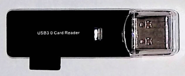

Michael --
I had great hopes for your step-by-step procedure, but I got precisely the same non-results as I reported in my previous post: eight different USB thumb drives (ranging in size from 1 to 16GB) failed to permit scanning. In each case, I made it to your step 11, at which point the printer said, "Cannot detect a USB flash drive" -- even though it had said in step 6, "A USB flash drive is connected."!
Very frustrating. I would like to be able to use whatever USB drive I have handy, but so far have had success (as I reported) only with the USB card reader.
EDIT: based on info in above posts, I purchased a 32G SanDisk Cruzer thumb drive and tried that, and sure enough, the MX922 was able to scan and store to this drive, in contrast to my bad results with my (mostly freebie) collection of other drives.
