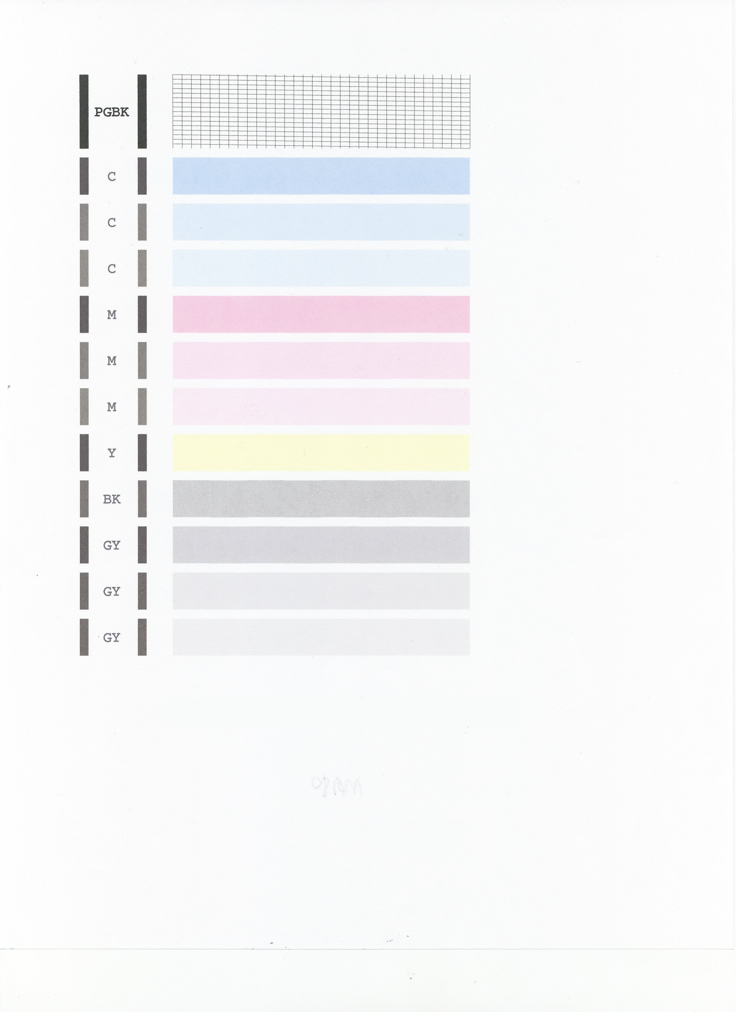

Please compare the nozzle check that you printed with this example:
On your nozzle check, did the black grid print to the right of  |PGBK|  at the top of the page?
If it did, the next step would be to perform an encoder cleaning:
https://support.usa.canon.com/kb/index?page=content&id=ART164632
After cleaning, please attempt to print again.
If no black grid printed or cleaning the encoder did not resolve the print issue, your PIXMA MG7720 would require service.
