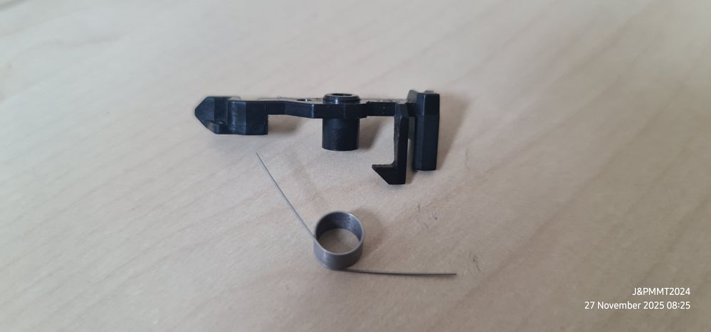

Good day.
I need to know how to put back a small black plastic part with a spring, which fell from my PIXMA MG3640S printer.
The numbering on the plastic piece is V2-4.
Thank you for your assistance.v2-4 and spring for pixma mg3640s printer

11-27-2025 10:21 PM - edited 11-27-2025 10:22 PM
My printer is in the same series as yours, it is an MG3620 and it looks like it has the same part as yours. I think if you open the front of the printer and look at the bottom left of the cartridge carrier, there is a white part that has a spring on the bottom left side of it, the spring is over a post ant the black piece clips over that. I have added a photo of the part inside my printer.
