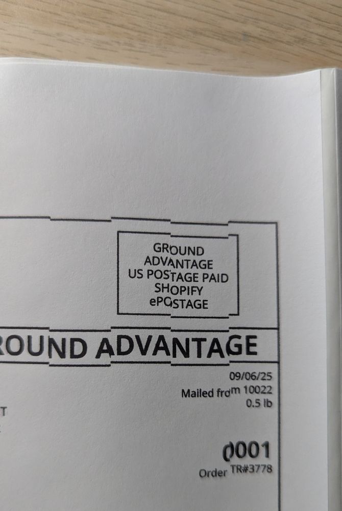

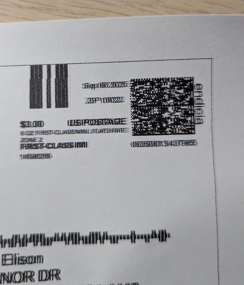

I ran BOTH manual and automatic Print Head Alignments as well as Nozzle Checks and other cleaning operations but nothing seems to be fixing the issue below. This is with a Canon PIXMA MG 3620 printer.

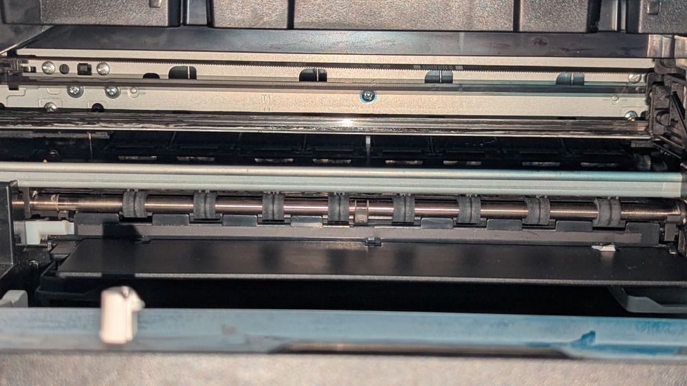

Blurry printing can be caused when the encoder/timing strip inside your PIXMA MG3620 is smudged. Cleaning this will resolve the issue.
To clean the encoder/timing strip, please follow the steps in this Knowledgebase Article:
https://support.usa.canon.com/kb/s/article/ART162575

Sadly cleaning the encoder/timer strip did not help with the print issues. Here's how it looks. There appears to be a blue-ish hue on the right side but it doesn't appear to come off with cleaning.

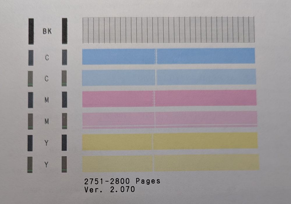

I also ran a Nozzle cleaning as it directed at the end of the article and it comes out as below (small cut across the bars).

HI harrisr,
Because cleaning the encoder did not resolve this issue, it would appear that your PIXMA MG3620 would require service.
