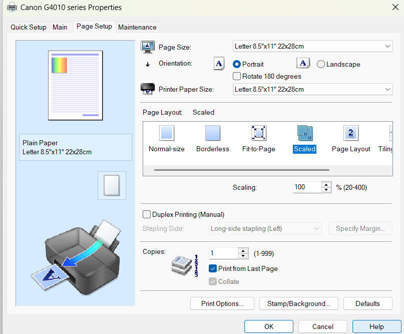

julez1987
I have a Canon G4010 printer and when i try to print using Word or Adobe Acrobat PDF an automatic margin at the top will appear and the bottom gets cut off. What really solved the problem is going to Printer Properties...under Page Setup...select Scaled. When i try to print again, it now follows the actual margin as seen on Microsoft Word. Take note that the default settings for most Canon printers was set to NORMAL SIZE. See attached screenshot.canon.png
