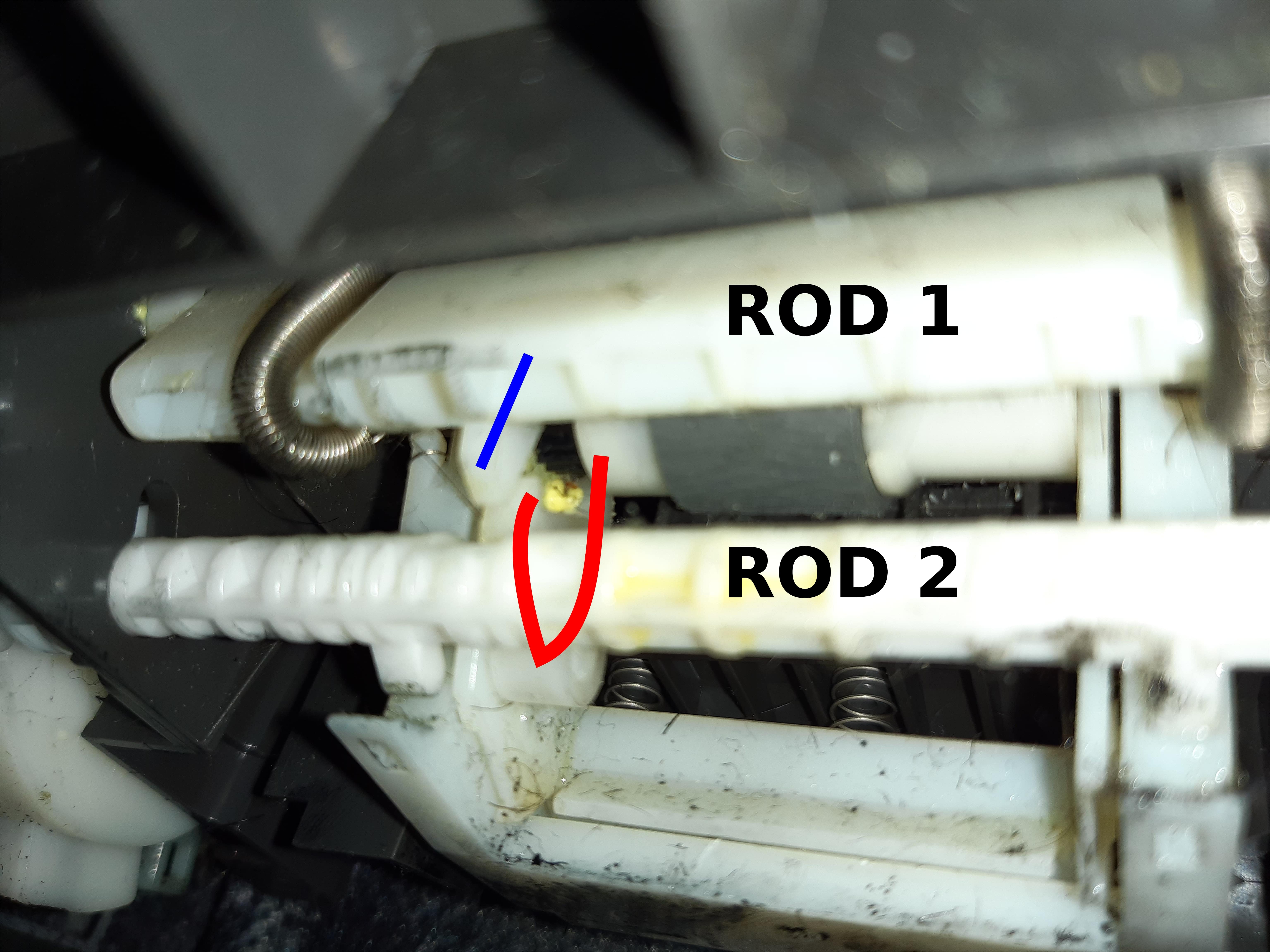

Having removed the paper feeding unit, I managed to take some pictures of it.
As we can see in the first picture, there's an upper and a lower roller.
The first one spins without moving vertically, while the second one should even move vertically.

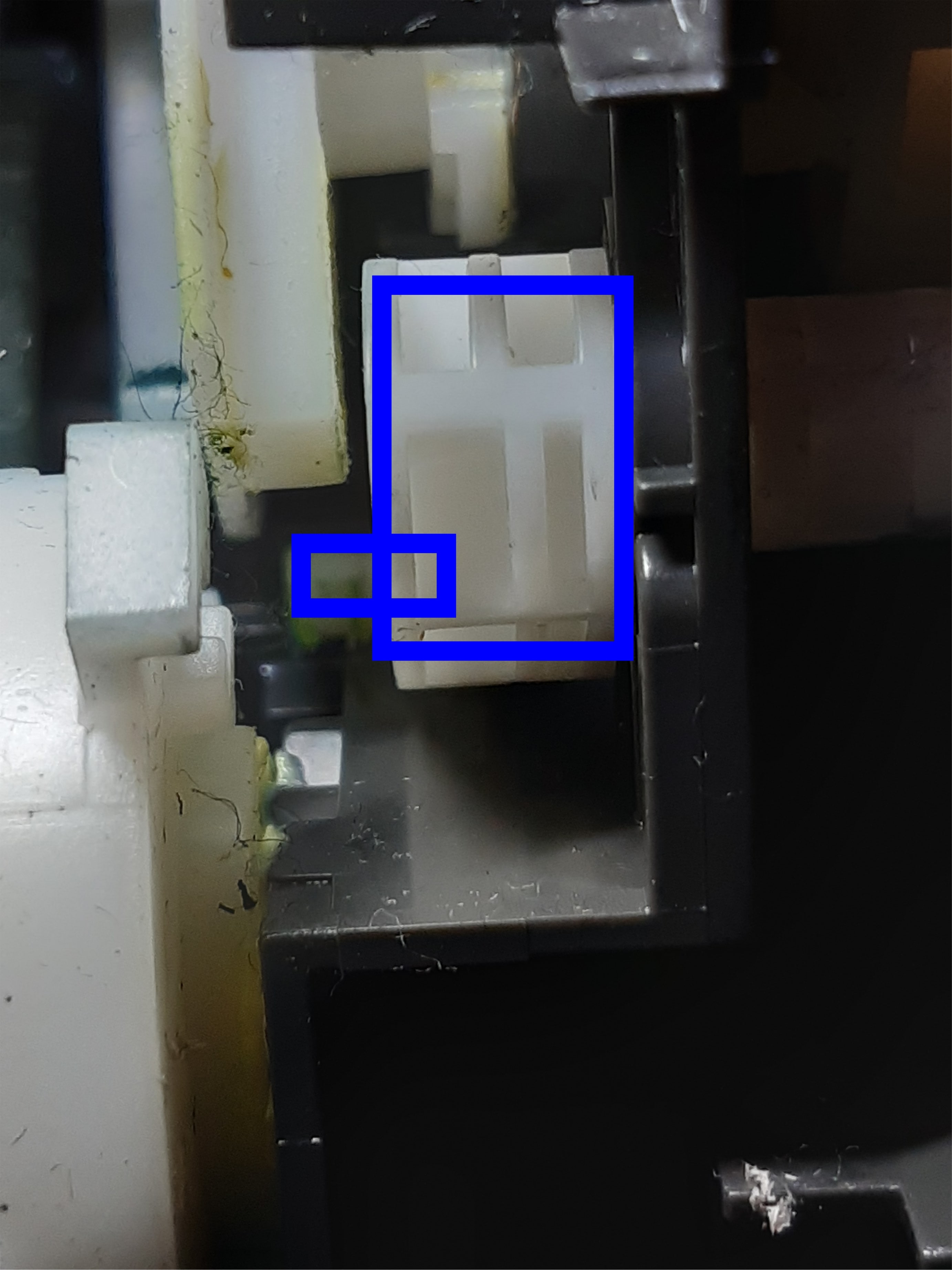

In the second photo I took, you can see the bottom of the paper feeding unit.
With the third picture I'd like to explain what I observed by moving something in the paper feeding unit.
By pressing the two little ledges (which I numbered 3 in the first picture), the rod 1 goes down but the tooth protruding from the same rod (I marked it with a blue line) doesn't touch the rod 2.
Behind the rod 2, I noticed a small lever (which I highlighted in red), able to move forward thanks to a small spring. The fourth picture shows this lever (V shaped) more closely, partially covered by the rod 2.
The first thing I'm interested to know is whether this lever must be in its current position or hook the tooth protruding from the rod 1. At the moment, the V lever is right below the tooth and it doesn't seem possible to force it to a different position.
Another thing I noticed (see the fifth picture) is that the rod 2 ends on the left side with a lever that, when I move the rod 2, seems to move in vain without hooking anything.
In my opinion, we have 2 different options:
- something that is hooked by this lever comes out only when printer is on and gives the command to feed paper;
- something has come loose (or broken) internally.
Otherwise, I can't believe that a lever with a tiny tooth at the end moves in vain without hooking anything.
I hope to get some useful answers to overcome this paper feeding problem. Thanks a lot!
