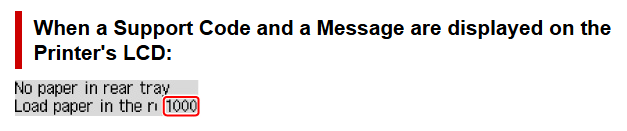

Once the printer is added back, please try printing. Should the problem persist (or if it returns) please look at the little display on the printer to see if an error is being displayed. Here is the section of the manual that has information about the errors that appear on the printer:
https://ij.manual.canon/ij/webmanual/ErrorCode/G7000%20series/EN/ERR/err_t_07_01.html?ref=err_t_07_0...
