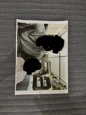

I have done everything : cleaning, deep cleaning, ink flush, … nothing works. Colors are washed out. And to discard any Color profile issue I made a trial printing from the scanner : same result.
print (sofa is grey)
 original
any idea? I am tired. For information I tried on my mac with latest macos (Tahoe) I tried from my iPhone. Printer is connected via WiFi. Tried already reinstalling the printer no change.

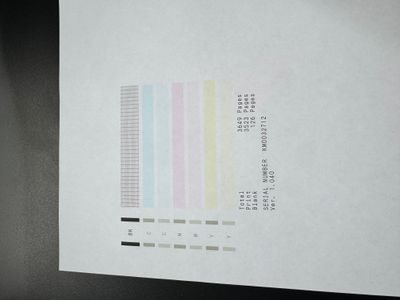

What does a nozzle check look like?
This is the output
Based on your nozzle check pattern, your black grid  is printing normally, but all three colors (Cyan, Magenta, and Yellow) are completely missing  The pale color blocks visible on your page are actually just the background placeholder labels printed on the template, not real ink
Because the entire color print head has stopped firing, the issue is caused by one of three things: air locks in the ink tubes, a severely dried print head, or ink valves being closed.
I know you have tried some of these fixes already. but hopefully a second round may break loose the ink.

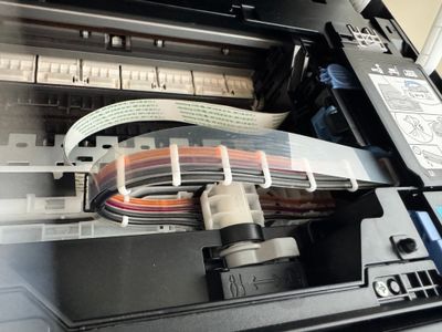

Lift the scanner bed of your MegaTank printer and look at the clear, flexible ink tubes leading to the color print head.
  • The Problem: If you see large pockets of air or sections where the tubes are completely clear (empty of cyan, magenta, or yellow), ink cannot reach the nozzles.
  • The Solution: Perform an Ink Flush through the printer menu.

Is the top one you printed after another ink flush?

top is before (but after all the maintenance steps)
bottom is after additional ink flush
