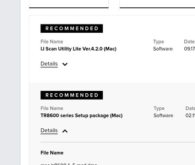

Greetings,
Can you please confirm the model number of your device? I don't see a TR8720a you referenced. I am familiar with the TR8620a
The TR8620a is supported under MAC OS 10.12.6 Sierra and later.
Drivers are available here:
https://www.usa.canon.com/support/p/pixma-tr8620a#idReference%3Dsoftware-drivers
Select Mac 10.15 Catalina OS for drivers download. <This is not a typo. These are the 2 packages which you will need.
Download both and save to your desktop. Then proceed with the steps below.
Disconnect the USB cable from your Mac
Open the printers and scanners applet and remove the printer instance using the minus key (-)
Next open the Applications folder and uninstall (drag to trash can) all Canon software drivers or utilities
important: Restart your Mac
Now run the TR8600 Series Setup. Do not connect the USB cable until prompted to do so by the installer.
Now run the IJ Scanner utility lite setup.
Printing and scanning should now be available. Please reply back with the results.
12-14-2025 03:04 PM
Rick. Excellent. Finally works. Your directions were the cat's meow. Thank you very much from Western Pennsylvania.
