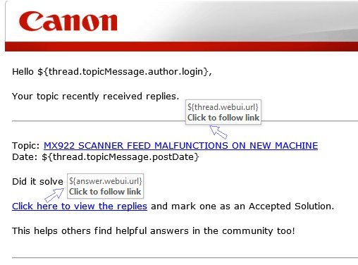

Not that this is the place to say this but someone in IT at this site should know that the email that was sent to me telling me that someone had replied to my question had links in it that weren't clickable and did nothing. I made a PrintScreen of what I see if I hover my mouse over either of them. Could you please pass along this info to a moderator or a Canon employee so that they can fix this?
If it matters, I get all of my emails in Outlook 2013 on my Windows 10 computer and have never had this happen on any other email that had links in it.

We get those emails as well, and they work on our end, and we've not gotten any complaints about these emails before. Could it be that Outlook is filtering out the information in the links as spam? If you log directly into the Outlook site (instead of using the desktop Outlook 2013 app), does the email look the same?

I really haven't a clue but the link in this last Reply of yours worked fine. But did you see how those links were chopped off in the PrintScreen that I posted asking about why they didn't work?
I've done nothing to my computer at all since when I got that other email with the links that wouldn't work. I've also done nothing to my internet connection or to my live.outlook.com email address which is the only one that is set up in my computer's Outlook 2013 using the Exchange ActiveSync setup.
