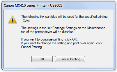

I have a Canon Pixma MX410. Recently I replaced the black ink cartridge, but, since I don't really need it, I left the old nearly empty color cartridge in. Now whenever I print anything, evne though I go to the printer propertires, then to maitenance, and then chagne the color settings to black only, when I hit print it pops up a window giving me the options to print in color or cancel printing and it says theat the settings in printer properties>maitenance will be overridden. If I print only a couple pages like this, they come out in purple (when they should be black) , which isn't too bad. However, when I try to print out more than just a couple pages, they start printing in a hard-to-read reddish-pink. Where do I have to go to change it to black only in the settings?

03-03-2016 11:54 AM
Thanks, but it still has the same problem. When I print, I get the following error message:If I click okay, then it prints in color only which really uses up my color cartridge quicker than I'd like.
