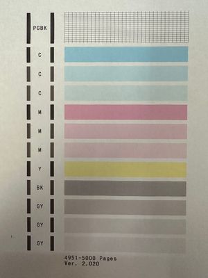

Hi, I have tried auto-deep cleaning several times for my MG7720. The attachment shows how PGBK patterns are misaligned. Does anyone know what I should do to fix this? Everything printed in black will be blurry, like there's a shadow for each character.

Hi luenceles,
Blurry printing can be caused when the encoder/timing strip inside your PIXMA MG7720 is smudged.
Cleaning this will resolve the issue.
To clean the encoder/timing strip, please follow the steps in this Knowledgebase Article:
Cleaning the encoder (timing) strip - MG7700 series

Cleaning the encoder strip did not help my printer.
Hi ChristinaGrace,
Please try cleaning the encoder again.  Please make sure to clean the whole strip, from extreme left to right.
If the issue persists, your PIXMA MG7720 would require service.  If your PIXMA MG7720 was purchased less than a year ago, please contact one of Canon's Technical Support Representatives via phone or chat to obtain your in warranty options. To contact a Technical Support Representative, please use the link below to log into your My Canon account:
https://mycanon.usa.canon.com
Once logged in, click on your PIXMA MG7720 and then click on the Product Support button.  When that page loads, click on either the Phone Support button or the Chat Support button to access support.
If your PIXMA MG7720 is out of warranty, you are eligible for Canon's Upgrade Program. This is for out of warranty units which have been diagnosed to require service, or for some reason are incompatible with a new or upgraded system. This option allows you a one-time opportunity to purchase a replacement product, discounted from the list price.
If you would like to take part in this option, please call our Sales Department at (866) 443-8002 Monday through Saturday, 9am to 9pm. Let them know you have been working with technical support and the Canon Upgrade Program was offered.
