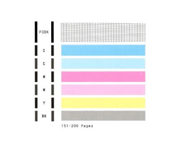

I have the same problem as mitica100. I've never had problems printing or copying until today after already printing and copying earlier this afternoon. Just like mitica100 the printer just started going through the motions (which means it's getting the instructions from the computer), but prints nothing. Now won't copy anything either. I've been through all items above. When I do the Nozzle Check, it prints just fine, and in black and white and color. ?
Hi moffitti,
Please compare the nozzle check that you printed with the example below.  Does your nozzle check look exactly like this example?
It probably would have, but when I fired up the printer this morning to reprint the nozzle check a job iapparently n the queue printed out just fine - no problem.  Go ifgure!
I did save a screen shot of what it should look like for future reference.
