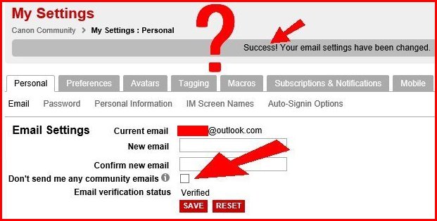

I haven't heard back from anyone so I've been trying to figure this out on my own. My first thought was to go into My Settings and change my email address from my outlook.com address to one of my Gmail addresses. But when I went to the page to do that, I see a box below the 2 boxes where it wants my new email address typed in and this box says DON'T SEND ME ANY COMMUNITY EMAILS. I must have checked that a long time ago since I thought it would keep any unwanted newsletters or other junk. Is that being unchecked what was stopping the Reply Notification emails from me?
I checked it for now and I kept my email address still on my only outlook.com email address which is my main one for both my computer's actual Outlook 2013 and my Windows 8 Nokia Lumia 635 phone that it needing to be replaced soon.

06-09-2017 10:33 PM
Hi, vankjeff!
We hope someone in the community is able to assist with your printer question! We wanted to mention, this community is designed for your fellow Canon owners to help each other out with any problems they may encounter. If this is a time-sensitive matter, of if you are looking to get support from Canon, please reach out to our US-based technical support team via Email at http://Canon.us/SupportCF
However, we can certainly assist with any questions you have about navigating the forum! The option you found regarding "Don't send me any community emails" option will prevent the community members from sending you any emails. To receive an email notification to a response on your post, just click on the "Subscriptions and Notifications" tab (here's a direct link): https://community.usa.canon.com/t5/user/myprofilepage/tab/user-subscriptions
Once here, click on "Notification Settings" and look under the "Email Notifications" heading to make any adjustments. You can also click on "My Subscriptions" in the same row to see the content you are subscribed to.
