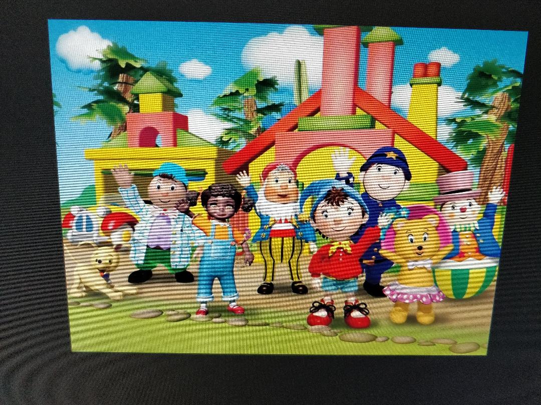

I have a year and half old Canon Pixma G1000 printer. I use it to take print outs of photos for like 6-7 prints in 10-15 days. From the past couple of days it is printing photos in greenish tint, like this-
This is the original image, photo taken from a pc but I hope you get the color difference
