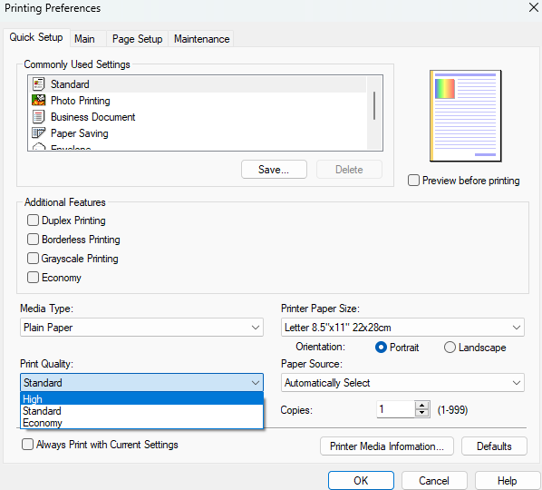

09-09-2024 10:03 PM
I had the same issue out of the box. I played around with printer settings on the printer itself based on other things I found and nothing fixed it, UNTIL I went to my print dialog and set print quality to "high" from "standard". Keep clicking on things like "system dialog" and "more settings" until you get to that page. I pasted the dialog below here, look for that exact page (Windows 11). Probably same/similar in Windows 10. Mac etc. not sure. This caused the printer to slow down and made all the difference.image.png
