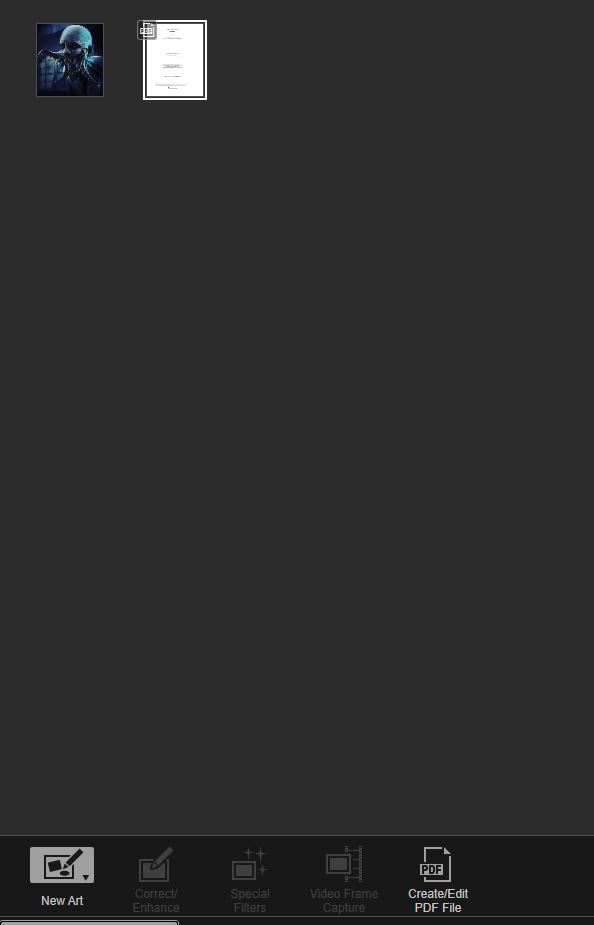

Image garden - after scanning a text document I need to crop the edges of the document but the "Correct.Enhance" icon at the bottom of the page is greyed out. Image of greyed out icon attached. How can I enable this?

In regards to the cropping issue, you can scan using the IJ Scan Utility, which will provide that option.
Please click on the Windows Start button and then the Canon Utilities folder. Click on the IJ Scan Utility to open that application.
Once open, please click on the Scangear button.
When Scangear opens, click on the Advanced mode tab in the upper right.
Place the item to be scanned and click the Preview button in the lower right corner.
The image will appear. You can crop the image to the size that you wish. If you are unable to crop, this may be caused by thumbnail view being enabled. Please click the button in the upper left corner to turn this off. Then you will be able to crop the image.
Once cropped, click the Scan button and your image will be scanned.

Thank you for the reply - it worked as expected.
