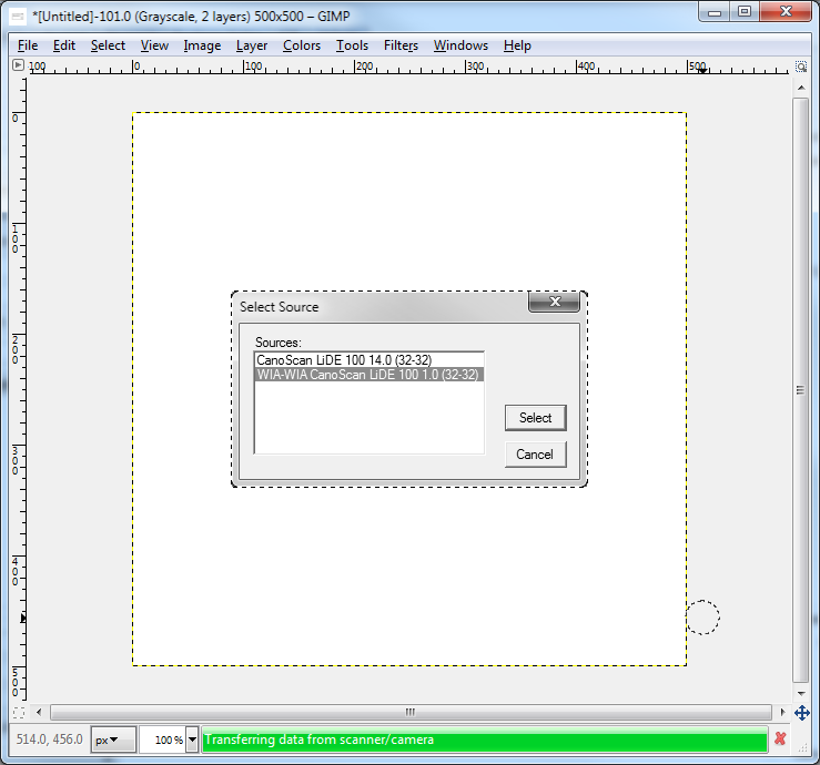

I have ended up scanning in GIMP (open source photoshop) and it has given me some pointers. Firstly it gives me a choice of driver - (see below)
The WIA driver works fine and I can do multiple scans – it proves the scanner works (but using GIMP to scan isn’t a viable solution)
The ‘other’ driver causes the issue and from what I can tell this is the twain derived driver.
Interestingly – if you look at the bottom of the below image there is a progress bar in GIMP that says “Transferring data from scanner/camera”
It’s frozen in that position and never completes and cannot be cancelled (tying up with the scanner being stuck in its non parked position).
