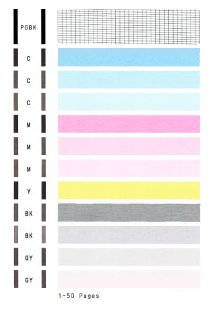

Hi ktfromkc,
First, please print a test page:
1.  Select Setup from the HOME screen of your PIXMA TS8020.  It is the gear at the bottom of the screen.
2.  Tap Maintenance.
3.  Tap Print nozzle check pattern.
4.  Tap Yes.
The Nozzle Check will print.  Please compare your printout to the example that has been attached to the bottom of this post.  If they differ, please perform a few printhead cleanings.
To perform cleanings, please follow these steps:
1.  Select Setup from the HOME screen.
2.  Tap Maintenance.
3.  Tap Cleaning.
4.  Tap Yes to clean the printhead.
5.  Tap Yes to print another Nozzle Check.
Does the Nozzle Check print correctly?  If you continue to have difficulties, please contact our support group using the following link:
http://Canon.us/ContactLI
