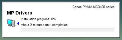

and then, once I clicked "Next" from "Step 2 Installation",
- if the Print Spooler is running, it will get stuck on MP Drivers Installation Progress: 0% (even when I leave it, it's still stuck here at 0% after hours):

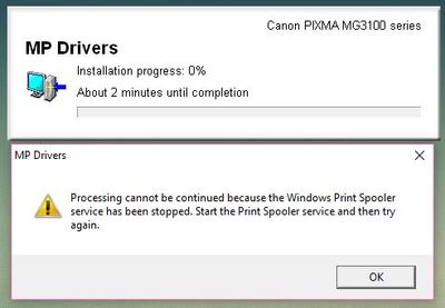

- if the Print Spooler service has stopped, it will pop up this error message - "Processing cannot be continued because the Windows Print Spooler service has been stopped. Start the Print Spooler service and then try again.":
This is causing me headache because if I don't stop the Print Spooler service in the beginning, I can never reached the installation of MP Drivers, but when I stopped the Print Spooler service, it pops up the error message at the installation of MP Drivers and I can never get past this step. Clicking "OK" will only bring me back to start.
Can someone please help me?
