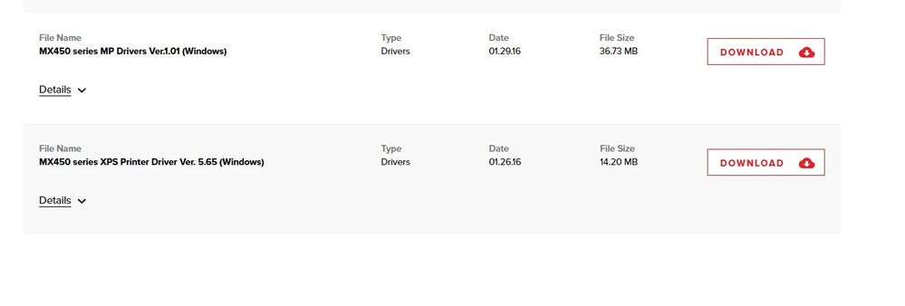

Are these the drivers you are trying to install?

Well John, I do not recognize the XPS Printer file as one that I deleted. Right now I am trying to download that one to join the other MP file but running into memory deficiency (I believe) in order to get past the EULA. I'll let you know if the XPS file is the one I need to install, though it seems not likely.
05-11-2023 01:58 PM
The XPS driver is a special driver that allows 16-bit printing. It is an “overlay” driver in that it first needs the regular driver to be installed. It also isn’t needed. Did the regular MP driver install OK?
