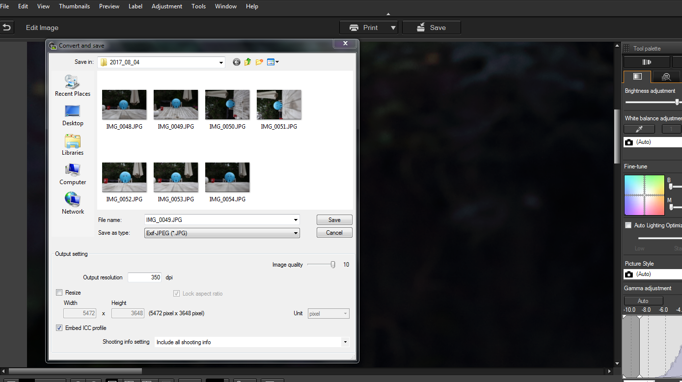

These errrors seem similar to mine. Recently bought 6D1 and have downloaded DPP4 as it was shipped with DPP3 (!).  I have shot in Raw and JPEG (i.e. duplicated).  When I edit a raw file and try to convert and save I get a window just displaying the JPEG images.  I then get the chance to convert JPEG to...JPEG! Is there a tick box  somewhere?  I have tried with a few raw images and the same problem. Here I was trying to convert the raw imager 0049 to Tiff or Jpeg to try the system.
