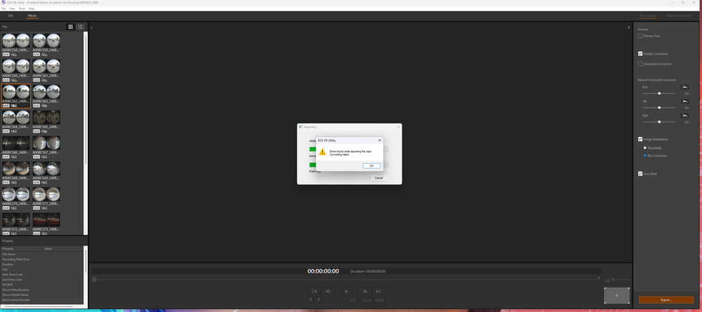

does anyone has the solution or the same issue. only two of my footages error when iam trying to export it the other footages is just normal

Hi prodbyclaire,
I'm sorry to see some of your files aren't export two of your files. I see one of the files that isn't converting in the list on the left of your screenshot. Which other file isn't exporting? Also what camera body and which dual fish-eye lens are you using to shoot the two clips that aren't exporting?

hey, did you found a solution for this problem? Because I have the same problem - from 7 RAW files, shot with CanonR5C, 2 are not able to export ... In Resolve I can playback them in RAW, but in EOS VR utility I cant export them to ProRes ....

Yes, I found a workflow to solve the problem. However, it was very complicated. I had to repeatedly render the clip smaller and smaller until I identified the exact point where the software kept crashing. Interestingly, it was always the same spot. However, that spot is not damaged in the raw material.
I then started exporting the part before and the part after that specific point separately. I have no idea what caused this issue. It took me several days, and I am very frustrated—especially since my clip was 60 minutes long.
