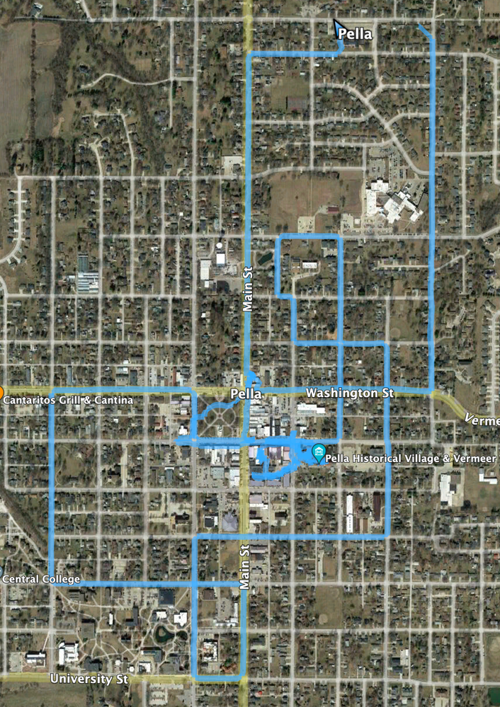

Yes, it could be, but not in this case. I posted earlier in this topic, running a separate GPS app at the same time worked fine. This is just a bug in Camera Connect. Since I know I cannot trust this app currently, I ran the backup app today. Unlike my April trip where I had the backup app set to log infrequently, this time I set it to log with any change. I was able to use the GPX file it created to correctly update my photos just like I used to do with external hardware loggers in the Stone Age of geotagging.
It logged everything just fine, per the photo of that log opened. This is just an issue with the current Camera Connect app. Since I haven't had any confirmation it works on other phones, it may be an issue with it and the G5X. Canon support has been provided all the data, but I never heard anything back on a solution.
