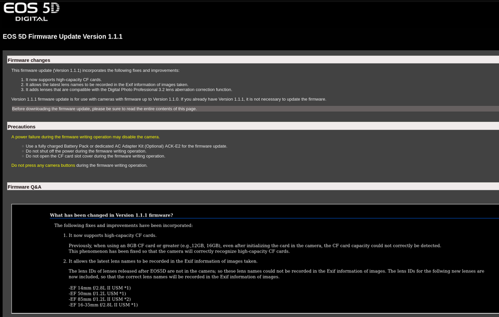

Does anyone happen to know a legitimate source for the latest firmware update for the first generation EOS 5D? The current version in my camera now is 1.1.0 and believe the latest final release for this now unsupported by Canon 5D is verion 1.1.1.

I use this website whenever I need to find older Canon firmware versions: https://pel.hu/eoscard/
03-13-2022 04:56 PM - edited 03-13-2022 05:22 PM
pel.hu/eoscard has.
Legitime source or not, you have the sha256sum here for the firmware updates. If the numbers are right, the files are legit.

In the case of my 5D with the 1.1.0 firmware, it wont recognize my 32GB memory card as anything more than a 8GB card. The newer 1.1.1 firmware addresses this, but I understand your point, maybe its best to just live with what I have than take a risk.

Here is a link where you can download firmware 1.1.1 for 5D Classic. It also has some of the instructions that need to be followed carefully when doing firmware updates. For additional, step by step installation of a firmware update, see any of the newer cameras where the instructions are still online.
You'll need a fully charged battery and a memory card without any photos on it (or anything else that you want to keep, because you'll need to format it in your camera prior to installing the new firmware file on it). It's critical to not interrupt the camera during the installation of the software.
