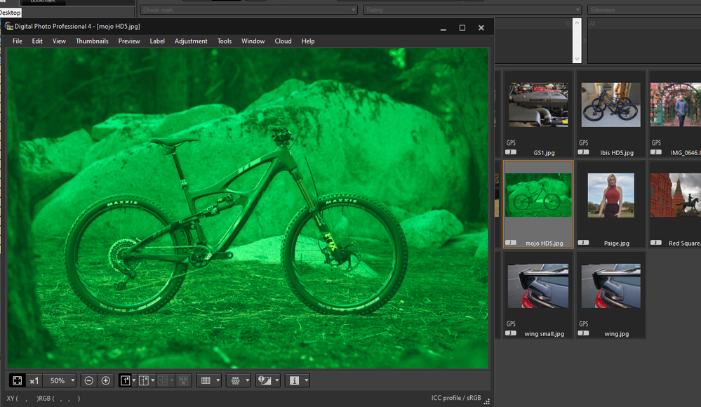

Have a strange anomoly in DPP. Tested with versions 4.12.20 and 4.12.60. File grabbed from the Ibis website on the web. Displays correctly in other software. Trying to figure out what DPP is interpreting incorrectly (white balance, color profile), etc?

Thanks Its an ibis Mojo HD5
https://www.ibiscycles.com/bikes/mojo-hd5
Select gallery. Its the third image

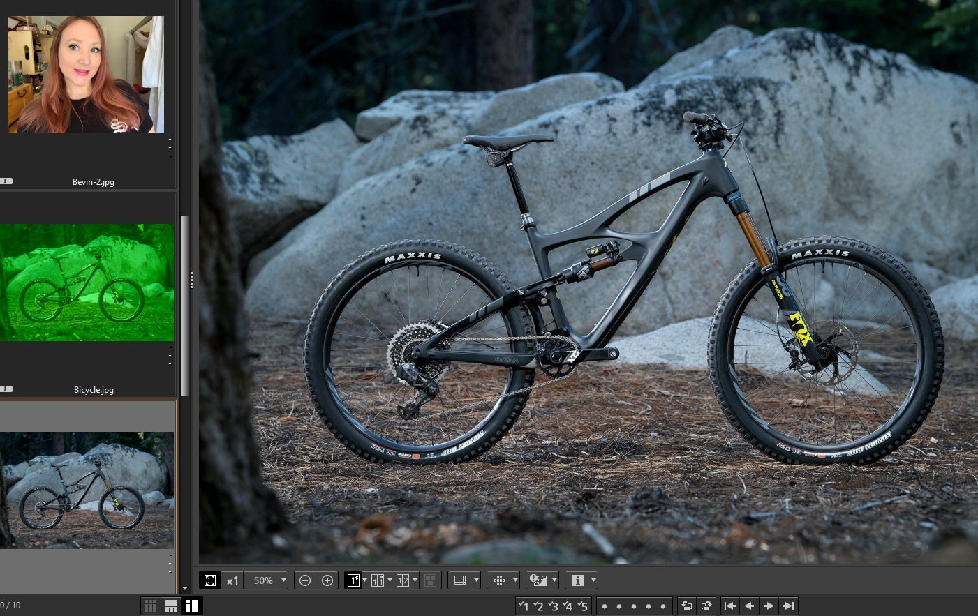

That is just crazy! I snatched the image, looked at it and messed with it in DPP 4. I opened it in another program and just saved it (no editing) and it opened properly in DPP 4. I know that isn't what you asked, but I did it anyway.
FD
08-09-2020 03:24 PM
I grabbed the picture using "save image as" in Firefox browser. Tried displaying it with DPP and got the same green image, with Paintshop Pro and Fastone Image viewer it displays in the proper colours.
I did nothing to the image apart from rename it and saved copies from Paintshop pro and Fastone.Both copies displayed properly in DPP. I then did a binary comparison on both copies and the original to find they were almost totally different in every respect.
The worrying thing is that the copies were about 40K smaller than the original, although I had both Paintshop pro and Fastone set to the highest quality output I wouldn't expect any slight compression to make that much difference.
I do wonder if the image contains adware that is designed to trigger something in the web browser, I don't think it is a DPP problem and would advise that you delete the original image from your PC.
In future it may be better to do a screen capture rather than "Save image as".

@Ray-uk wrote:I grabbed the picture using "save image as" in Firefox browser. Tried displaying it with DPP and got the same green image, with Paintshop Pro and Fastone Image viewer it displays in the proper colours.

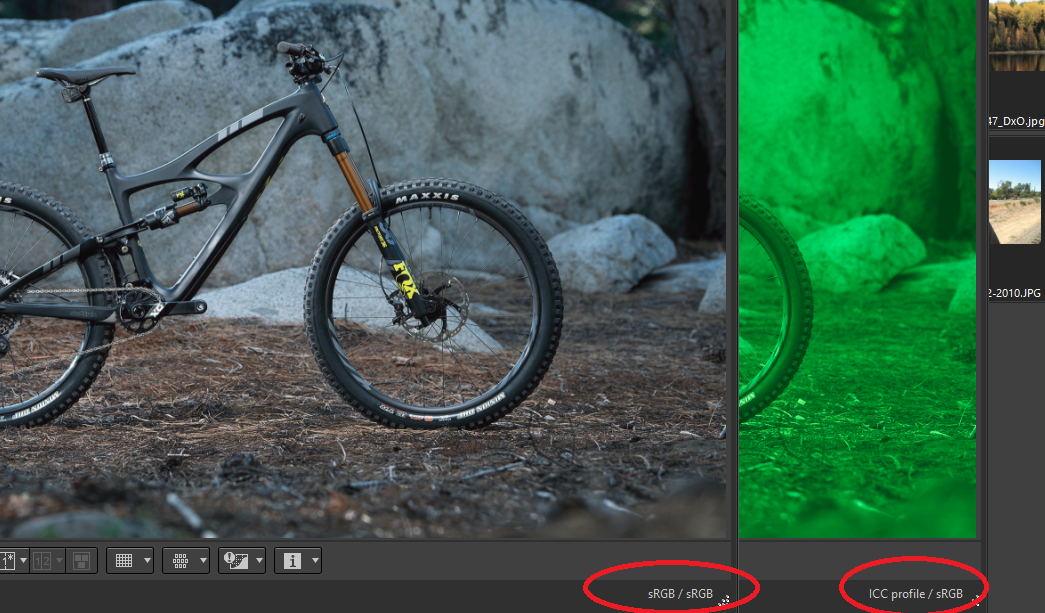

I looked at both the original "save file as" from Firefox and the converted file that looked ok in DPP with UltraEdit, which is an ASCII / Hex editor. Some of the header info in the converted file was deleted or shifted. The shifted info was moved deeper in the file, e.g., color space, ICC profile, sRGB reference, etc. I noticed in the original from the web site, there was a reference to a Hewlet-Packard 1989 copyright and a URL to the International Electrotechnical Commission (IEC). I couldn't find that in the converted file, but it still could have been there, I just might have missed it. The downloaded file looks safe.
I think some of that extra header info confuses DPP, especially the color profile. It seems that I read, on this forum, that people were having trouble opening some tiff files with DPP.
FD
