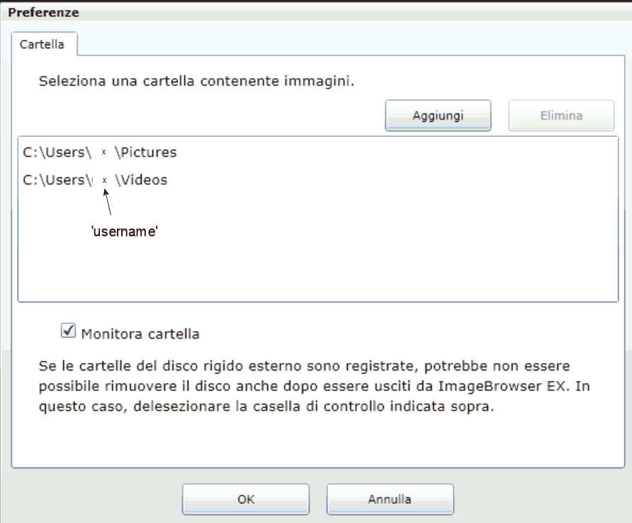

I have retried from the beginning and, after physical deleting the mentioned folder, restarting ImageB, searching ..., I see
now, I click on "add" and get
where the 2 folders are those ones prestored in ImageB
here I delete them and add my folder (pictures and movies) and OK
After a regular searching the starting ImageB screen displays all what is in my folder.
Do you get all that above?

PS: adding to "Preferred" try to add first only a dummy empty folder and look if ImageB crashes, if not add a little folder and loook, ....
