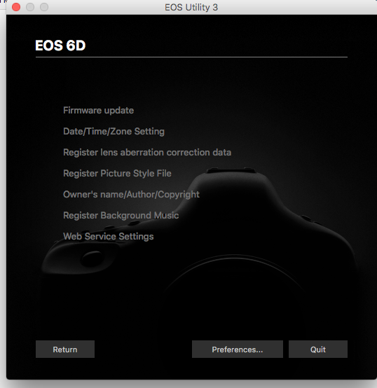

I have updated the latest EOS Utility, 3.5.10 on my Mac. When I plug in my Canon 6D, all 3 items on the main page are highlighted, but when I click on Camera Settings, all the settings are grayed out and I can't click on them.
Any ideas?

Turns out it didn't like that it was on the video setting instead of picture setting. Thanks!

Is WiFi turned off?
11-22-2016 07:05 PM
I am plugging it in directly to my computer with a USB Cable. Do I need Wi-fi?
11-22-2016 07:06 PM - edited 11-22-2016 07:10 PM
No. But if wifi is on USB communication is off. Also, what computer operating system.
11-22-2016 07:10 PM
Oh okay, yea the Wifi is off.
10-19-2018 11:28 AM
Hello everyone, it's pretty simple, just make sure the camera is on picture mode NOT video mode, you can even switch with the camera on while plugged into the computer, the menu options should turn white right away!
02-15-2023 04:16 PM
BINGO! Thank you!
11-20-2024 02:04 PM
Mine is on photo mode and still does not work. Does it need to be plugged in via cable or is WiFi ok?
