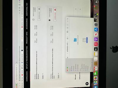

So there is an update for my lens. Currently the firmware on our T7i’s is 1.0.6 and the last updated firmware is 1.0.7 as seen in the image attached. So formatted the card, put the file right in the main directory and when I select update the lens firmware on the camera with the correct lens the update screen goes black as soon as I select update.

07-16-2023 02:11 PM - edited 07-16-2023 02:24 PM
What is your exact lens model? There are at least two 100-400mm lenses. This firmware is for version 2 (II) of the lens. It won't work with the original version of the lens.
