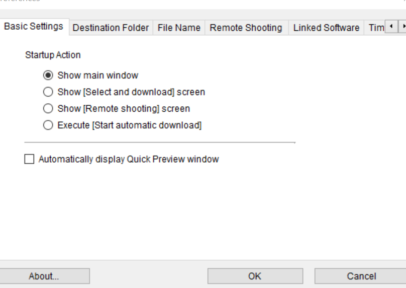

09-24-2021 03:47 AM
I connected the cable to my camera and a notebook. Fired up EOS utlity. Select images to download and hit enter. I was getting the message after downloading 10-20 images. I clicked on preferences -> basic settings and untick automatically display quick preview window. It seems to work as I downloaded the whole set of 35 images (raw and jpeg),

11-12-2022 10:58 PM
Turn off auto shut down under Power Saving in settings. It defaults to 1 minute

11-13-2022 12:37 AM - edited 11-13-2022 12:37 AM
It does work, but even so it still disconnects after the 30 minute maximum for display shut down so you would have to set a timer and tap the shutter button before that lapsed. Find a card reader is the better way to go because it’s also faster but this is the solution to the original issue at hand
