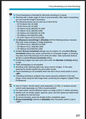

From the EOS 90D manual:

One more suggestion.
Use either Darktable or Rawtherapee for developing the raw CR2 files and save a 16 bit TIFF.
The "capture sharpening" in Rawtherapee does a Richardson/Lucy deconvolution to remove small aperture diffraction blur. The radius for "capture sharpening" must be chosen based upon spacing of photosites on the sensor chip and FNumber. F/16 would require twice the radius as F/8 and for your camera, it is likely not needed for F/5.6 unless there are other forms of Gaussian blur in the image and then the radius should match the blur radius.

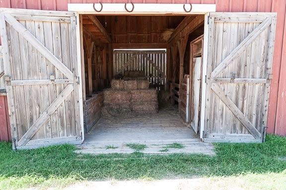

First let me know are you using the iPad for stacking or a computer? My suggestion is, and has always been, to anyone the best is Photoshop/Lightroom on a full size desktop and monitor. Now for sure other platforms work and some do a reasonably good job but they are not PS/LR. That is why some of the other editor's ads say just as good as Photoshop or comparable to Photoshop. Photoshop is the standard which all others are judged.
Just exactly how are you going about"stacking"? From exposure to editor.
A photo like this is not possible unless more than one exposure is made. That is where photo stacking comes in. Is this what you want to achieve?
You can expose for either the very bright outside daylight or the very dark barn inside but not both in the same shot.
I need more background info from you.
