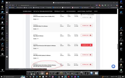

The latest software and information for your camera is here:
Canon Support for EOS 6D | Canon U.S.A., Inc.
If you select the W7 OS option you can download a digital version of the original CD that came with the camera.
