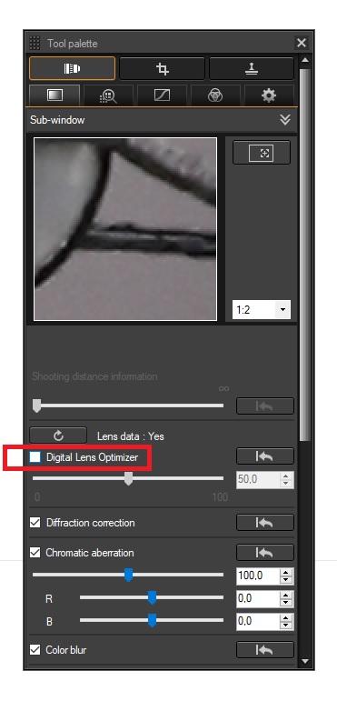

Hi, I am having problem with DPP 4.7.1 (tried older versions, problem is the same) when applying "Digital Lens Optimizer" on certain pictures.
After selecting the lens optimization on the RAW file the program crashes ("Digital Photo Professional 4 has stopped working")
