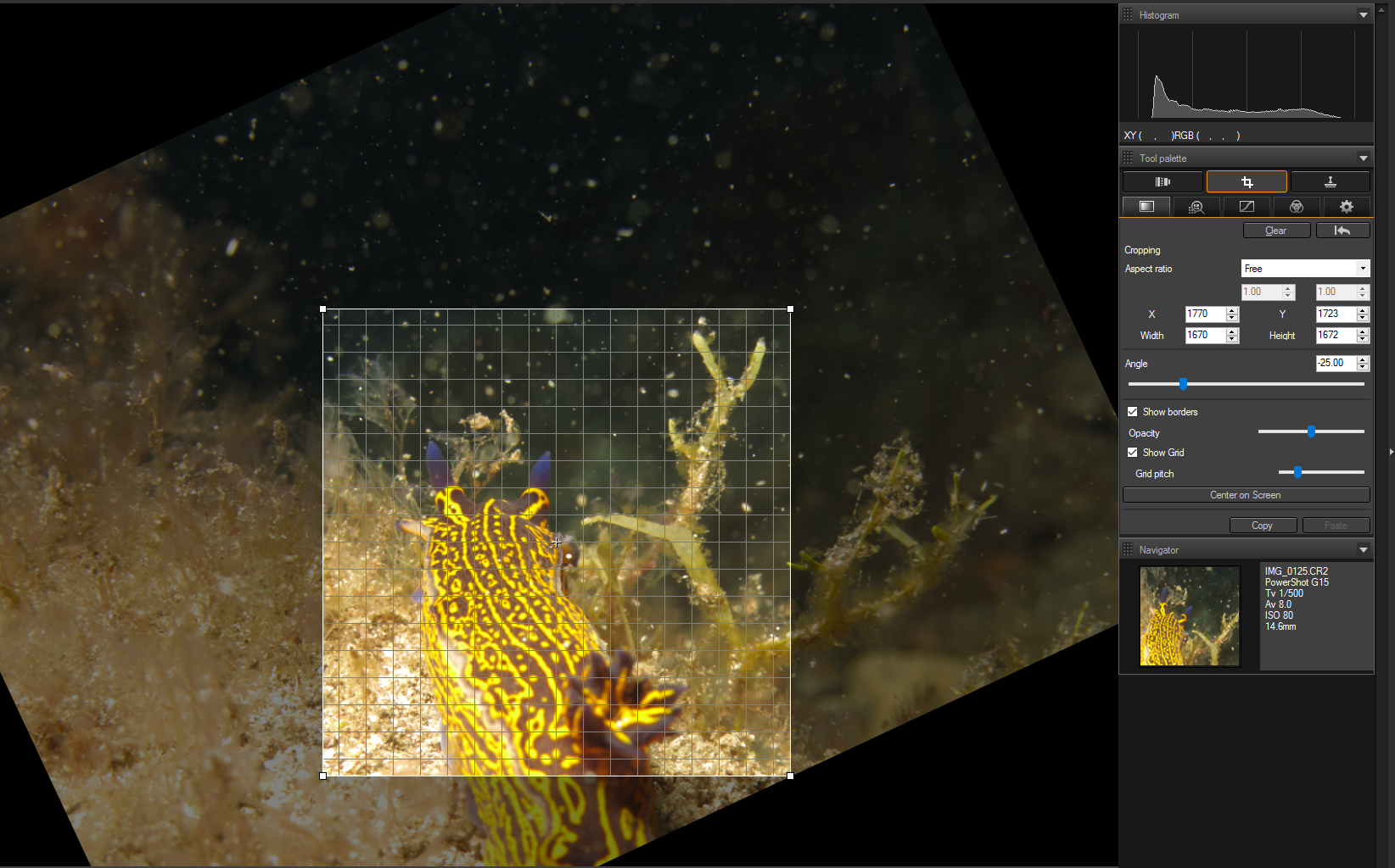

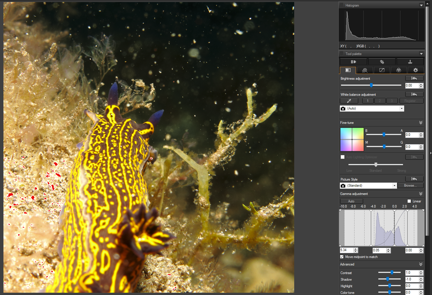

I have some photos where I rotate and crop the image.
But, when I return to the Image adjustment page, the image is only cropped, not rotated.
If I re-enter the Crop and Rotate tool, the image is shown both with rotation and cropping.
Am I doing something wrong here?

@hdohlmann wrote:You are right, the cropping is also off, probably because the rotation is not being applied.
No, I do not have the image opened in multiple views.
Here are links to a couple of the images that does not work for me:
https://drive.google.com/open?id=0B92Kvd-y39zAX3gyaV8wVmpkREE
Rotated -25, closely cropped.
https://drive.google.com/open?id=0B92Kvd-y39zAVTNZc3Z6UUNlelk
Rotated -7, closely cropped.
It is not the negative rotation that is the issue. I tried rotating the first image +25 instead, but it is still not applied...

Henrik sent me the RAW files, and I tried editing them with DPP 4 (4.6.10.0) and DPP 3 (3.15.0.0). Both are the latest releases, as far as I know.
It's clear that something is wrong. I was able to apply Henrik's edits correctly to both images in DPP 3, but in DPP 4 the rotation was not applied to either image. In both cases the rotation showed in the crop/rotation window, but not when I returned to the main editing window (IOW, just what his earlier post shows). So the problem isn't something he's doing wrong or the way he has the software installed, or whatever. There must be a bug in the way that DPP 4 handles .CR2 files from the G15.

@Robert: Can you also reproduce the Insufficient Memory issue for img_0125 by clicking Auto under Gamma Adjust, as described in another thread?

Yes, I reproduced that error on both images. It would certainly appear that they didn't do a very good job of testing DPP 4 on RAW files from the G15.
