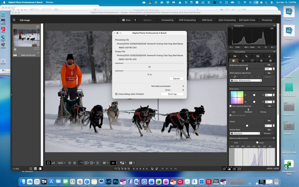

Screen Shot 2026-03-15 at 19.45.51 PM.pngScreen Shot 2026-03-15 at 19.45.51 PM.png
MacBook Air M2 macOS Tacoma Full Disk Access authorized.
Are you working with Canon .CR2 or.CR3 files? Do they open OK with Apple Preview?
If so, may be a particular issue with your computer. Give Canon support a call at 1-800-OK-CANON.

Thanks John. I am working with .CR2 files. I upgraded to Tacoma, and have given Full Disk Access to DPP. I still have issues. BTW my DPP also crashes on launch. I was able to get around it by launching it with sudo privileges from my terminal. Wondering if that could be the main issue. How do you launch your DPP, and how did you get around the supposed permissions issue?

I just double-click the icon, like any other application. Only permission I have had to apply was Full Disk Access.
Sounds like you know your way around macOS. Maybe delete all traces of DPP. I believe various bits and pieces are stored in different folders. Maybe one of the app cleaner apps from the App Store could help. Then try a clean install.
