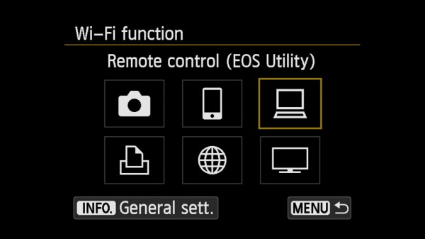

It does not seem from M50 documentation that camera support that type of connection.
I have a M6 and the wifi is supported only to be used for connection with Android or I-Phone by Using Canon Camera Connect.
Generally the EOS utility require to use a USB cable except for higher gamma models, like EOS R, EOS 5 and few APS-C ones, there is no EOS wifi network support.
To see if your camera support the feature check if there'is the computer icon within your camera wifi icons, it is the one with yellow box around here below.
Wi-Fi EOS Functions camera menu
