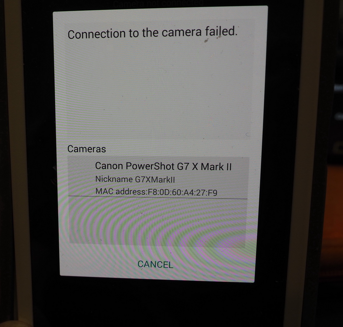

Since last month, I cannot connect Galaxy Note 3 with Canon g7x mark ii.  Previously, there was no problem connecting.  Other devices can still connect with this camera and other camera software programs also can connect with Galaxy Note 3.  Whenever I try to connect, it shows "Connection to the camera failed".  Please refer to the pictures below and advise how to restore this connection / fix.  Thank you. oc 1_resize.jpgoc 1_resize.jpg
Hi JJUN83,
If you haven't already done so, please update the Camera Connect App from Google Play. Once that's complete, please erase your camera's Wi-Fi settings, then re-enter them.
