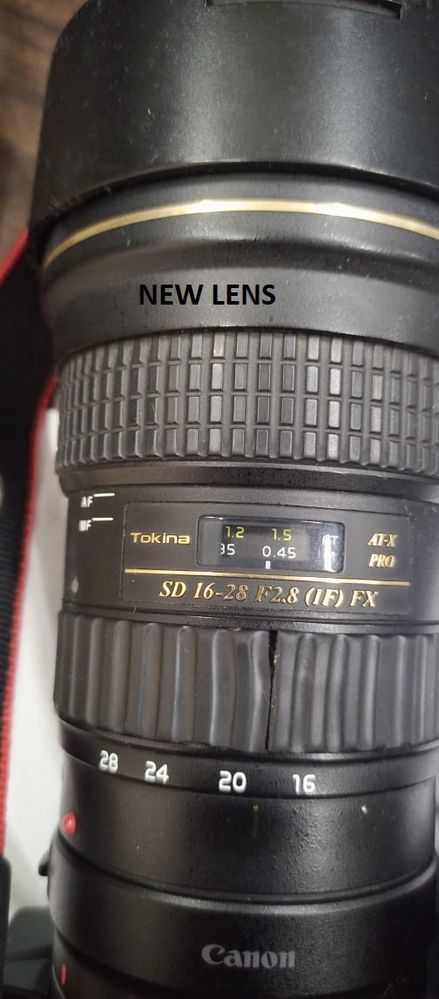

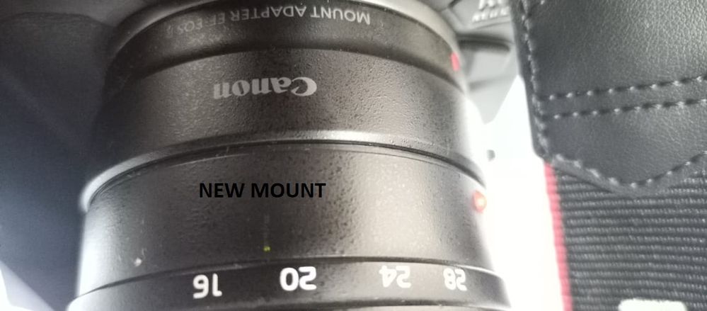

I bought a Canon R6 Mark ii and had to buy a mount adapter to use my Tokina EOS lens 18/28 which I used to use on my old Canon 6D mark ii.
Now when I photograph, there is like a ring flair on the photos? WHAT TO DO NOW!

I am almost certain it is the lens in the image I posted, which is an older full frame lens. Even if it were made for crop sensor bodies, it would still use the full frame EF mount. I cannot think of any third party manufacturer that actually uses the EF-S mount when the EF mount is sufficient. Why make two mounts just for Canon bodies?
I have asked the OP to post a sample image of the issue, as well as the lens on another body without a hood.

Appreciate the response. There is a bit of a time difference. I'll post a photo of the lens we have in the office and the result we are getting. My boss is pissed at me and it's been a very distressing day. I'll surely update you in the morning . Thank you
08-23-2024 10:31 AM
We don’t need to see a photo of your lens. Just confirm the full model number.
Wewould like to see a photograph that shows the issue, so that we can better understand your issue.

posted photos below
