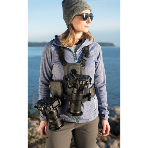

Was wondering if anyone uses a cotton carrier something similar,  to carry an r5 with a 100-500 mm lens. Wanting to know if it safe for camera to attach camera directly  to carrie,r or would I need to attach to lens foot, because of weight . Would it damage the camera or lens.  Attaching it to lens foot would make it too high on my chest to be comfortable

As tempting at the Cotton Carrier looks, as Waddizzle said, I wouldn't do it.  Gravity and the weight of 3lbs swinging suspended just isn't a good idea in the long run.

Good point.  The Cotton Carriers seem like they would work well for photo-journalists and wedding photographers.  Typically, you are using smaller lenses for those shooting scenarios, not a telephoto lens with a lens foot.

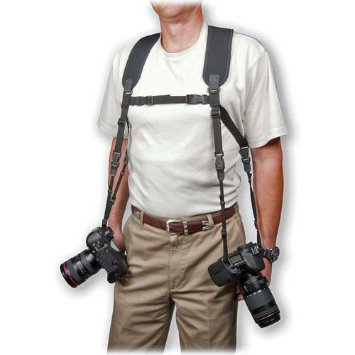

Sorry to hear about your neck injury.  I have neck and chest issues myself.  The Cotton Carrier system looks to be pretty good.  It would work much better than the dual strap thing in the second photo.
43627DA2-A920-43E6-A770-20EF9803E4FC.jpeg43627DA2-A920-43E6-A770-20EF9803E4FC.jpeg0C426317-CC6F-4966-97FF-CBD6398196DC.jpeg0C426317-CC6F-4966-97FF-CBD6398196DC.jpeg

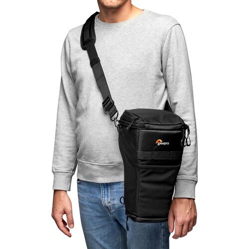

But, I see no reason why one could not use a camera holster on the dual strap harness, instead of attaching a fully exposed camera.  It is something that may get really heavy on your body in a really short amount of time.
This is the Lowepro ProTactic TLZ 75 AW holster, which is an updated version of the Lowepro holster than I have used for several years.  I have totally forgotten that you can take the waist strap and reconfigure the shoulder strap to turn it into a chest carrier.  It also includes a rain cover, just like a backpack.
The shoulder strap extends much longer than what you see in the photo.  I am pretty tall, 2 meters, and the top of the holster can hang at my belt line.
This updated design allows the bottom to extend .  I can carry a pro-size body with a 70-200mm lens with the hood reversed.  The extension feature allows you to carry the combo with the hood in the shooting position.
