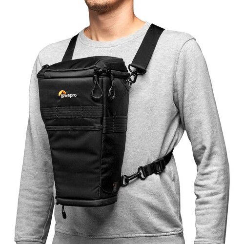

This is the Lowepro ProTactic TLZ 75 AW holster, which is an updated version of the Lowepro holster than I have used for several years. I have totally forgotten that you can take the waist strap and reconfigure the shoulder strap to turn it into a chest carrier. It also includes a rain cover, just like a backpack.
The shoulder strap extends much longer than what you see in the photo. I am pretty tall, 2 meters, and the top of the holster can hang at my belt line.
This updated design allows the bottom to extend . I can carry a pro-size body with a 70-200mm lens with the hood reversed. The extension feature allows you to carry the combo with the hood in the shooting position.
