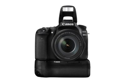

I happen to have an archive of product images for Canon DSLR cameras. I used to download all the product images that Canon sites published when new products were announced. Unfortunately it does appear that Canon made a change to the battery grip at some point.
The EOS 70D was the first camera to use the BG-E14 battery grip. The product shots I have for that camera include several of the battery grip and one of the camera fitted with the battery grip. In all of these there is no Canon logo visible on the front of the grip.
EOS 70D Canon Europe press shotsEOS 70D Canon Europe press shotsEOS 70D Canon Europe press shotsEOS 70D Canon Europe press shots
For the EOS 80D the product pack shots also include the grip as a standalone item and attached to the camera. Interestingly this grip has the additional Canon badge visible on the front.
EOS 80D Canon Europe press shotsEOS 80D Canon Europe press shotsEOS 80D Canon Europe press shotsEOS 80D Canon Europe press shots

Thank both of you for a quick and straightforward reply.  Finally, I can rest assured mine are authentic. There’s nothing posted anywhere on the net, except here , in this forum with great contributors as you both. Thanks vet much!!
