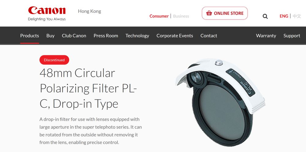

The early non-IS versions of the white telephoto primes use a 48mm drop-in filter but I thought all of the IS versions used the 52.  I don't have a 600 f4, but my 200, 300, 400, and 800mm Canon primes all have IS and all use the later 52mm drop-in.
This is a photo of the earlier lens version, shown (but discontinued) on Canon's HK site.

Rodger, it looks like you nailed it! My filter holder has that same center button for the release of the lock. Now the search begins for one of those. Thank you so much.
You are welcome!  Probably one of the used places will have them showing up at times or on ebay because a lot of the earlier Canon lenses used that holder so plenty were sold.
Good luck with your quest 🙂
