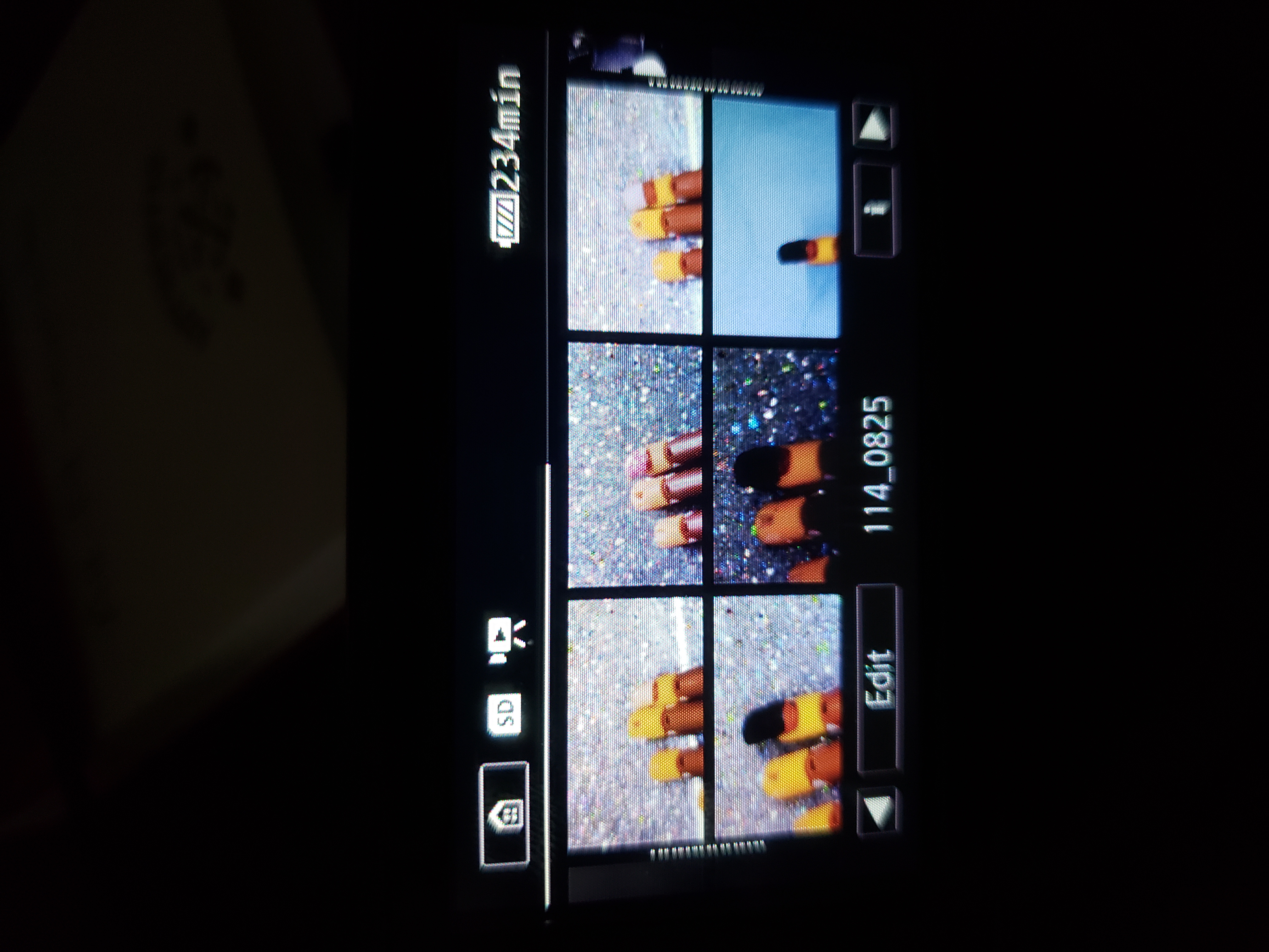

I'll get a reader as soon as I can. But here is a video and a couple photos to show what I mean.

Second photo shows the videos are indeed on the card. (I'm in a nail tech, it's a trainer hand.)

Files are on the card (I'm a nail tech, it's a trainer hand)
