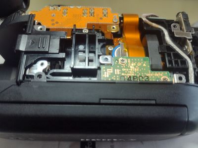

Hello guitarpicker7. My internal battery in my Vixia HF G10 is also dead, and I haven't been able to charge it for some time. A while back, the charger stopped working. I figured out that the van's cigarette lighter plug has the same connector. I charged the internal battery a couple of times in the van while driving but that doesn't seem to work anymore. I plan to open it up and see if can find the battery with the help of my gear head sweetie. I have one more plan before I start to do that. We found another charger 12 volts and will wire it to a connector from a cigaret charger cord that fits the camera. I realize it is supposed to be 8.6 volts. I ordered one from amazon but that just popped loudly a couple of times as soon as we plugged it in. Yikes. So no luck there. Fingers crossed that nothing else is wrong.

I've taken my Canon vixia apart and I'm ready to replace the internal battery. I'm a little afraid to take the soldering iron to it but that's the next thing. Then I assume the battery will tell me it's part number and I can find it and order it online. Fingers crossed.

Hello Tjoernfelt, Did you take the internal battery out and replace it? I'm at the same point you were when you made this post.
