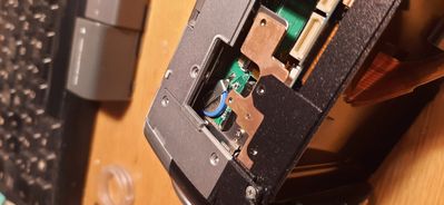

Did You finally locate the battery. I've found it soldered to the circuit board in the bottom of the camera. At this very moment, I'm trying to recharge is, as You've described. It's my second HG10, as the flip out screen crashed on the first. I broke a connector in a attempt to replace, and unfortunately before saving recordings. The battery in the first camera still holds power after 6 years. I do not like the idea of replacing it with the circuit board in place, but am even more a
fraid of taking it appart.

I have had little concern about my battery packs. But when I changed it, I lost time and date. As I still had my first HG10, with the defective side screen, lying around, I chose to remove the internal battery for the fix. It was an easy task, done not taking the camera more apart than in picture. I don't know the type of battery, since the connectors are placed covering that detail. I charge the battery packs sitting on the camera. I'm not sure, they are up to full capacity now (or will be again)

I'm glad you shared the photo and you are correct- I found a place that charges $120 to change the B/U battery! I now have 11 HG10s, all of them have bad B/U batteries. I should say HAD... it's a quick fix and you will need some soldering skills, but soldering is easy and a talent quickly learned. I used the "pre-tinned connecter" routine and just a touch of the soldering iron secured the replacement battery in place.
Hint- On my first try, I took photos after each step, no matter how small or insignificant it seemed.
It made a wonderful reference when I was putting it back together...
