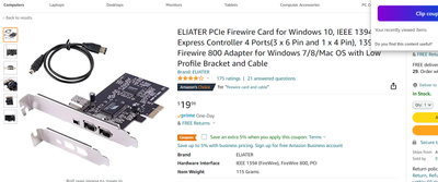

If you want to edit, you'll need a FW card. That was the standard of the day. The camera is 4-PIN, the connector on the card will be 6-PIN.
This example includes the correct cable. 4 > 6 pin. PCIe, supports any slot 1x ~ 16x. VIA based chipset so no problems under windows or (intel) based MAC. Includes bracket for full or half size slot.
If you try to use it with a M1, it might not work. PC is your best bet. Also, there should be plenty of free older software to perform basic capture, cuts, fades and wipes, add text, etc.
As Wadizzle said, newer apps may not support 1394a standard, but I know you'll find something.
